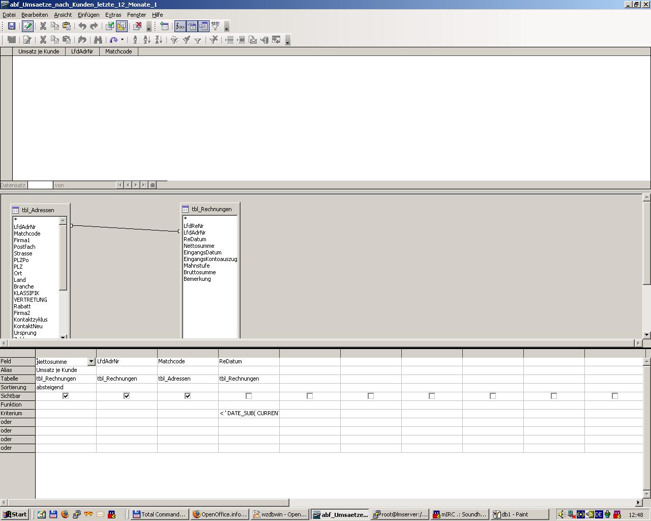

Re: Inhalte eines bestimmten alters
CREATE TABLE IF NOT EXISTS `tbl_Rechnungen` (
`LfdReNr` int(11) default NULL,
`LfdAdrNr` int(11) default NULL,
`ReDatum` datetime default NULL,
`Nettosumme` double default NULL,
`EingangsDatum` datetime default NULL,
`EingangsKontoauszug` varchar(50) collate latin1_german1_ci default NULL,
`Mahnstufe` smallint(6) default NULL,
`Bruttosumme` double default NULL,
`Bemerkung` varchar(50) collate latin1_german1_ci default NULL
) ENGINE=MyISAM DEFAULT CHARSET=latin1 COLLATE=latin1_german1_ci;
CREATE TABLE IF NOT EXISTS `tbl_Adressen` (
`Matchcode` varchar(20) collate latin1_german1_ci default NULL,
`Firma1` varchar(50) collate latin1_german1_ci default NULL,
`Postfach` varchar(8) collate latin1_german1_ci default NULL,
`Strasse` varchar(40) collate latin1_german1_ci default NULL,
`PLZPo` varchar(5) collate latin1_german1_ci default NULL,
`PLZ` varchar(5) collate latin1_german1_ci default NULL,
`Ort` varchar(40) collate latin1_german1_ci default NULL,
`Land` varchar(5) collate latin1_german1_ci default NULL,
`Branche` varchar(10) collate latin1_german1_ci default NULL,
`KLASSIFIK` float default NULL,
`VERTRETUNG` varchar(20) collate latin1_german1_ci default NULL,
`Rabatt` float default NULL,
`Firma2` varchar(50) collate latin1_german1_ci default NULL,
`Kontaktzyklus` int(11) default NULL,
`KontaktNeu` datetime default NULL,
`Ursprung` varchar(20) collate latin1_german1_ci default NULL,
`Zahlungen` int(11) default NULL,
`Umsatzab94` float default NULL,
`Waehrung` varchar(20) collate latin1_german1_ci default NULL,
`GehoertZuAdresse` int(11) default NULL,
`UeberlieferungErlaubt` bit(1) default NULL,
`Poster` bit(1) default NULL,
`Buchhaltung` varchar(15) collate latin1_german1_ci default NULL,
`Lieferantennummer` varchar(20) collate latin1_german1_ci default NULL,
`UStIDNr` varchar(20) collate latin1_german1_ci default NULL,
`BeiAngebotenBeachten` longtext collate latin1_german1_ci,
`BeiAuftraegenBeachten` longtext collate latin1_german1_ci,
`Info` longtext collate latin1_german1_ci,
`Homepage` varchar(50) collate latin1_german1_ci default NULL
) ENGINE=MyISAM DEFAULT CHARSET=latin1 COLLATE=latin1_german1_ci;und dann soll das mit den rechnungen rauskommen ...
- db2.jpg (122.18 KiB) 1668 mal betrachtet
was kommt denn raus, wenn Du die Einschränkung nach Zeit weg lässt:
Wenn diese Abfrage richtig formuliert ist müsstest Du ein Ergebnis bekommen.
der 1. von beiden codes geht , aber es ergibt sich das selbe wie vorher , er zeigt alles
der 2. code sagt syntax fehler

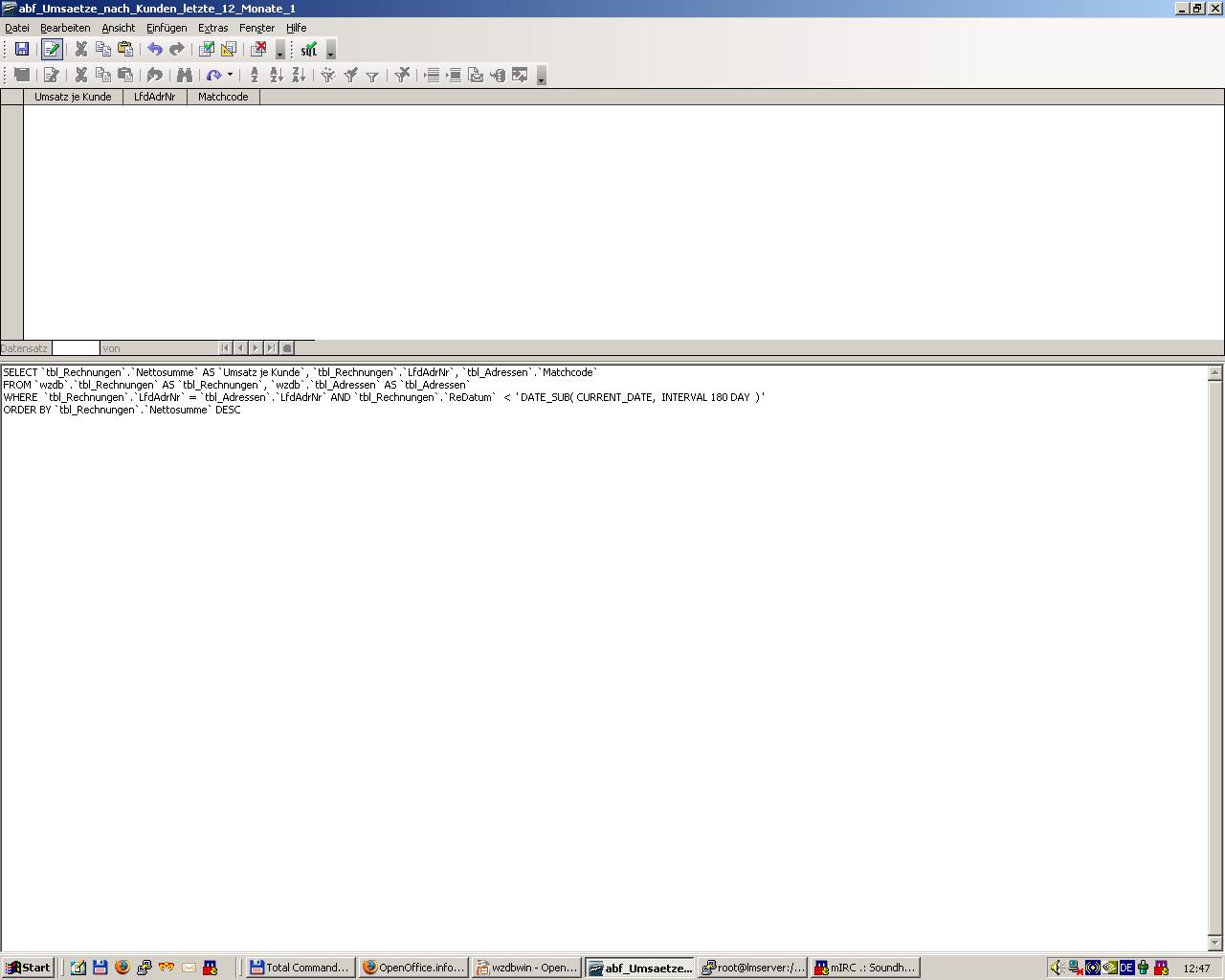

- komma4
- Beiträge: 5332
- Kontaktdaten:
Aktiviere mal in der SQL-Ansicht unter Bearbeiten>SQL-Kommando direkt ausführen!
(der Schalter war hier mal eingestellt - weiss der Kuckuck, warum der weg war.
Damit klappt die Abfrage hier (JDBC):
War es der Schalter?
WHERE `rechnung`.`datum` > DATE_SUB( CURRENT_DATE, INTERVAL 365 DAY) War es der Schalter?
Cheers
Winfried
Winfried
juhu
so tut es
wobei ich das vermutlich das SQL ausführen wohl der einzigste fehler war *hmpf*
SELECT `tbl_Rechnungen`.`Nettosumme` AS `Umsatz je Kunde`, `tbl_Rechnungen`.`LfdAdrNr`, `tbl_Adressen`.`Matchcode`
FROM `wzdb`.`tbl_Rechnungen` AS `tbl_Rechnungen`, `wzdb`.`tbl_Adressen` AS `tbl_Adressen`
WHERE `tbl_Rechnungen`.`LfdAdrNr` = `tbl_Adressen`.`LfdAdrNr` AND `tbl_Rechnungen`.`ReDatum` > DATE_SUB( CURRENT_DATE, INTERVAL 365 DAY) ORDER BY `tbl_Rechnungen`.`Nettosumme` DESCwobei ich das vermutlich das SQL ausführen wohl der einzigste fehler war *hmpf*
